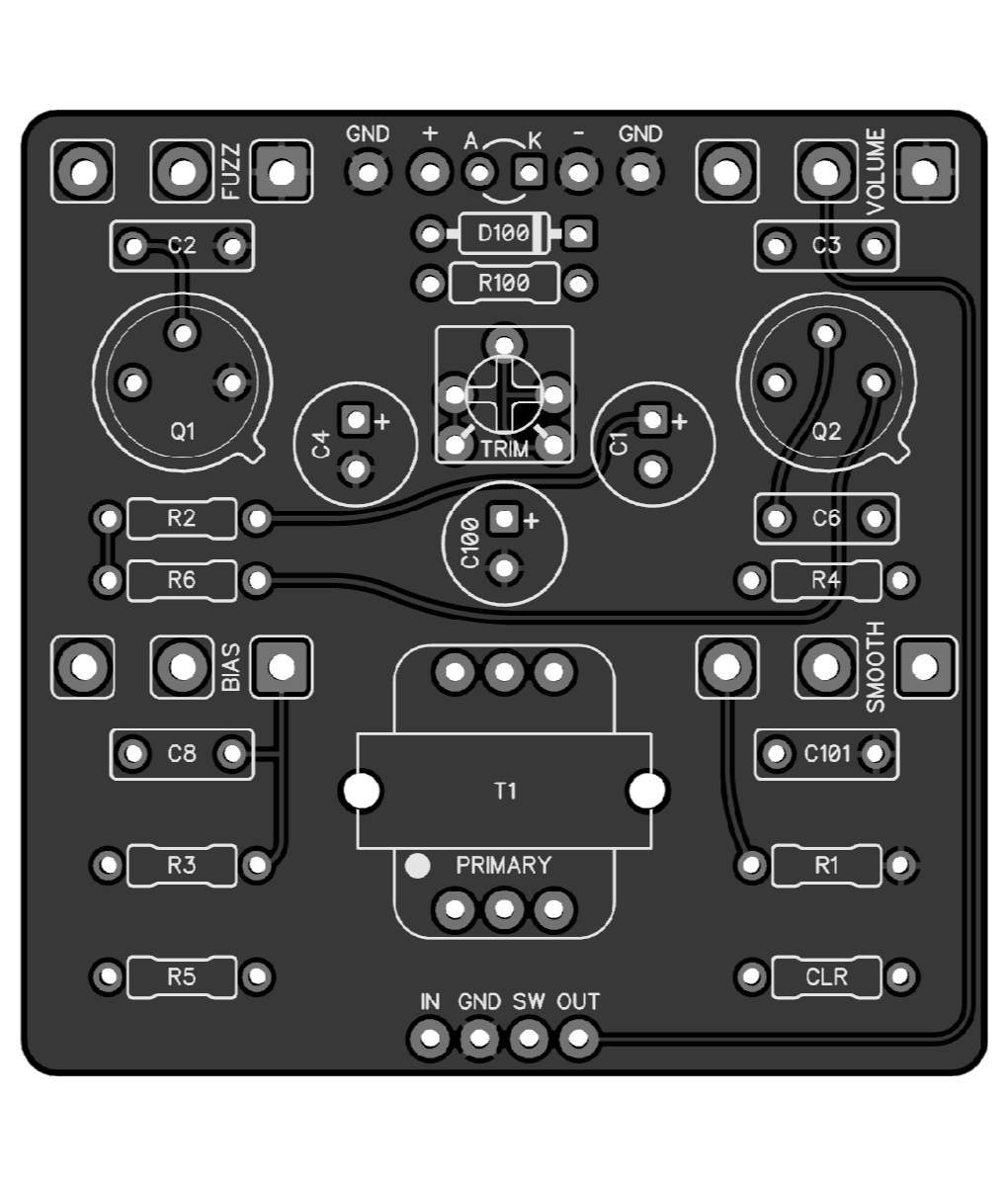

harmaes (verified owner) –
Noticed this pedal in some YT videos and found out Robert created a PCB for it. So I ordered and evaluated some NPN germanium transistors. I learned from Robert that the ones in the original were around 120 and 180 HFE with a low leakage. So I found someone on eBay with the CV7351 with a similar spec and just installed these. Biased around 4,5v with the bias pot around the middle position and it’s a very cool fuzz now!
