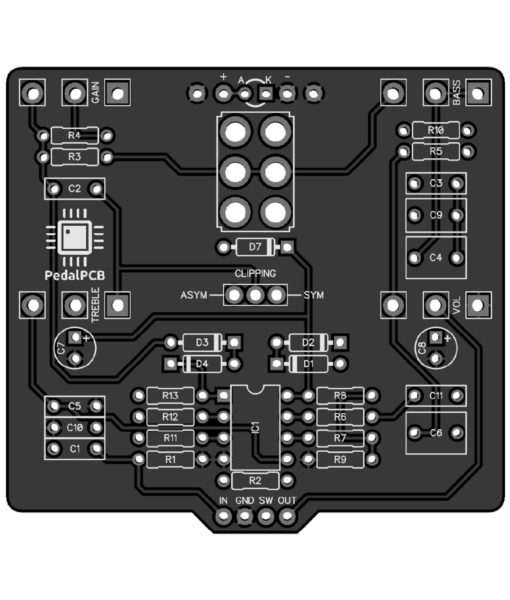

Overview
The Tommy is inspired by one of the original boutique pedals that kick started the pedal craze. From clean boost to light overdrive, this little beauty can be an always-on tone shaper or used to boost an amp into overdrive.
- Volume – Control the amount of output signal
- Gain – Control the amount of signal gain
- Bass – Adjusts the level of bass frequency cut
- Treble – Adjusts the level of treble frequency cut
- Gain Range (Toggle) – Shifts the range of gain available with the Gain control
- Mode (Internal switch) – Toggles between Symmetrical / Asymmetrical clipping

I bought this when the V2 Timmy was discontinued and prices skyrocketed. It sounds every bit as good as the real deal, but I’m giving 4 stars for the pot values.
The original uses log (A taper) for the Treble, Bass, and Gain controls, which prevents things from getting bunched up at one end of the sweep. I highly recommend subbing those in for the Linear pots listed in the build doc. Oh, and a TL072 is a killer sub as well!
BoscoBirdswood (verified owner) –
The quality of these PCBs is amazing and puts Tonepad to shame. Losing 1 star for the “in the style of” denomination where the values are not true to the Timmy, and lacking the ability to reduce to 2 clipping diodes as per the original.

I like having the internal switch for symmetrical vs. asymmetrical clipping. I had no idea what would sound better, but it turns out I have a very strong preference for the asym clipping on this pedal. I thought I’d want to have easier access to that switch, but for me I liked to be able to compare and then set it forever. The gain switch is really helpful depending on whether you’re using this pedal as a light OD or boost pedal vs. a dirtier OD/distortion pedal.

This is an awesome distortion box. Lots of tonal options. The only thing I changed in the build was the internal clipping switch. I used a toggle switch and put it where the LED goes, and moved the LED down next to the foot switch. I like all the options accessible.
