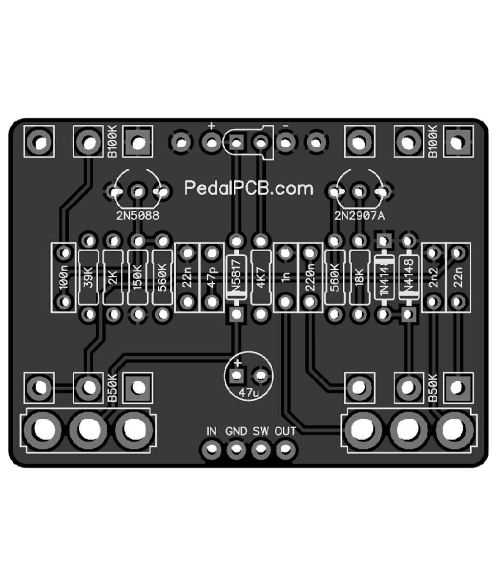

- Volume – Adjusts the overall output volume
- Gain – Controls the amount of fuzz
- Mood – Starves the supply voltage
- Bone – Controls the overall frequency response
- Range (Toggle) – Controls the range of the Mood control (Hi or Lo)
- Presence (Toggle) – Controls the signal presence

A really fun fuzz and simple build. Make sure you insulate the lower pot pins from the switches.

I’ve reviewed this before. It is great. The three-way presence switches on the original and this work-alike are very subtle. I’ve found increasing C6 to 3.3nf-4.7nf and C7 to 10nf-15nf a much more noticeable and usable range. Especially if you use this for bass. Which you should 😉.
As others have stated, this is a fun and easy fuzz to build- a definite favorite of mine! I’ve built several and even added a GeSi switch of my own to a few. Any high gain PNP Ge transistor will work, and it makes for a nice change from the Silicon saturation.
