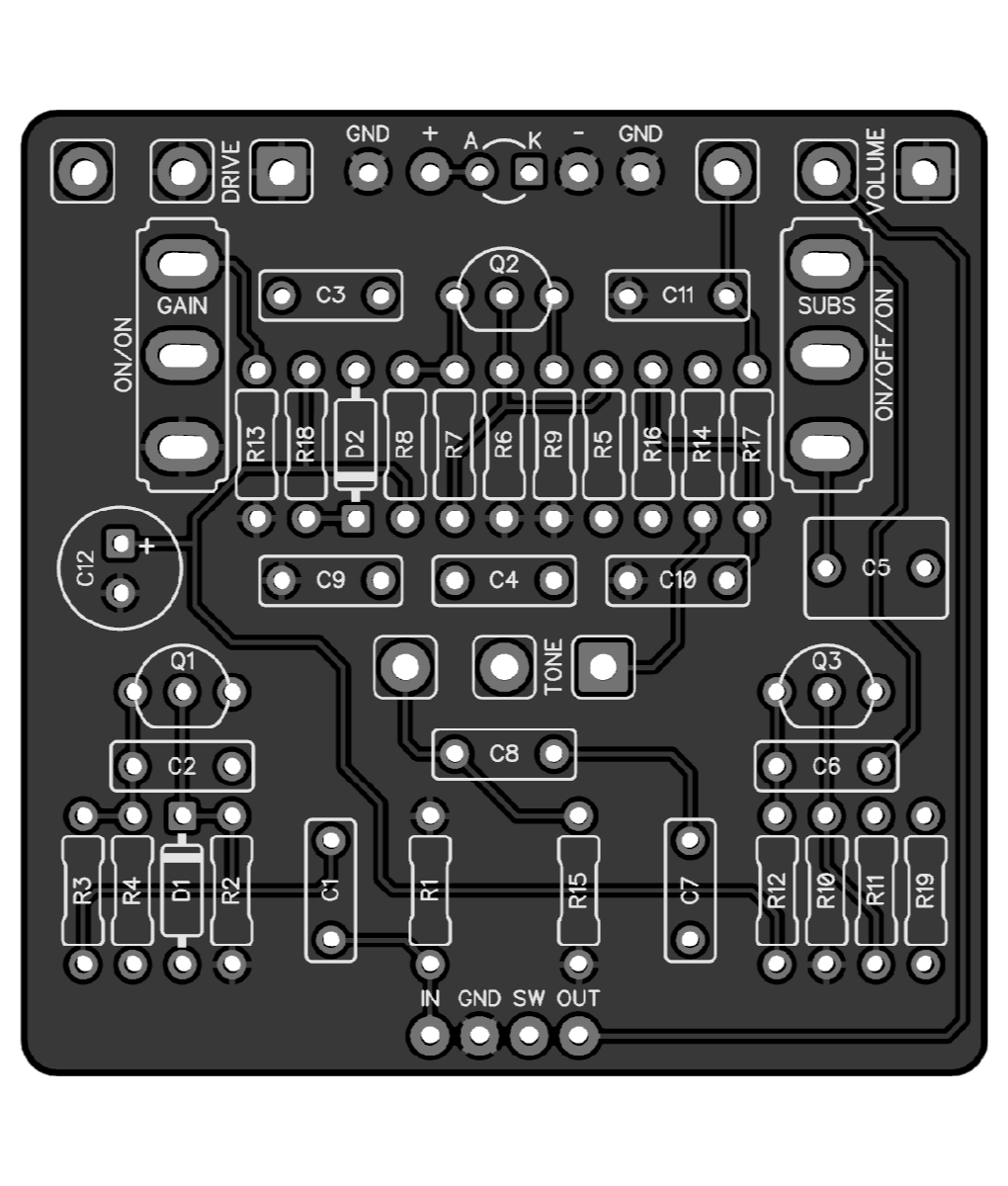

- Volume – Adjust output volume level
- Tone – Adjust treble content
- Drive – Sets the amount of distortion (may crackle)
- Subs (Toggle) – Controls the amount of sub-bass frequencies
- Gain (Toggle) – Toggles between high and low gain

MICHAEL GURLEY (verified owner) –
I built this, and could not get it to sound like the BOR that I had years ago. I checked a different schematic, and the tone cap C8 was 100nf, not 10nf. NOW, it sounds awesome, just like I remember. You might want to socket that, and play around with it.
