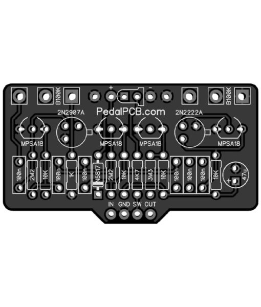

Alex Kirts (verified owner) –
Full CCW is silent or un-usable until about 11 o’clock. Read about the same problem on tagboard and these layouts look the same. Its a bummer bc the pedal sound pretty good at full clockwise, but unless you play hard and / or have a signal boost in front of it the control knob half un-useable. Not a reflection of PedalPCB bc the board is done well but stinks that there isn’t an accurate clone of this pedal out there.
PedalPCB –
I’ll look into this, if the circuit isn’t accurate I want to fix it.
beat (verified owner) –
I have the exact issue as Alex.
Was anything ever concluded to fix the problem? I, too, would love to have this pedal fully operational. Thanks- Chris
PedalPCB –
An original was retraced and compared. The behavior was similar, but can be improved slightly with some modifications.
See this thread.
It’s a rough circuit, demo videos do a good job of showing usable settings and avoiding the weaknesses.
kroars (verified owner) –
Very cool circuit and super easy to build. Although you may want to socket the transistors to play around with them. Also, I took Roberts advice and changed the Vol pot to A100k and Control pot to C100k as well as flipping the 2n2907 around so tab is on opposite side from silkscreen. These seem to fix the issues mentioned above. Tons of fun playing/building this one!
