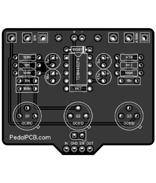

Excellent clone of tone bender professional MKII circuit, simple to build, i put 3 AC125 germanium transistors into instead of OC81D, more easy to found, and result is perfect. Graou.
swaptronics (verified owner) –
Excellent pcb and clone of the TB Pro MKII circuit. The charge pump IC is great allowing you to connect positive ground. I used NOS TI 2N404 transistors in my build and put in a 20K pot for the 8.2K resistor to bias the Q3 transistor to -4.5V DC for optimal tone. Brilliant design!
Rafael Azevedo (verified owner) –
Incredible pedal from spitty to creamy cleans up really nice. I used 3 AC124s and this is awesome.
Great fuzz. I used 3 2n404s I bought off Amazon. They sound great.
