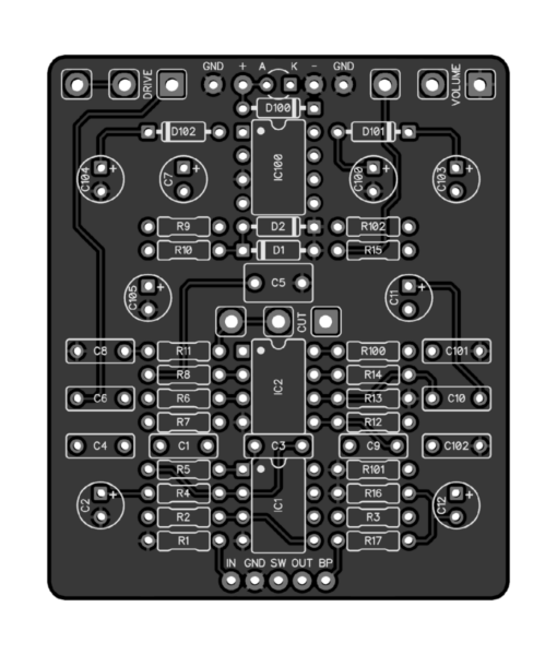

Disclaimer: I have never played the original pedal this is based on, the 1981 Inventions DRV, nor have I played an OG RAT.
However, I have built a lot of drive pedals, most of which I thought were ok, but not what I’m looking for.
When I first plugged this in, I was kind of disappointed – it sounded like a pretty typical hard-clip distortion pedal. You could hear the sharpness of the silicon clipping pretty clearly. I wasn’t impressed, and tossed it in the “sell” pile.
Then, I decided on a whim to mess around with some op amps I forgot I had. After some tinkering, I settled on a TL062 for IC2, and an OPA2134 for IC1.
This thing is AWESOME now. The lower slew rate of the TL062 takes a lot of the sharpness off and makes it much smoother, while the even HIGHER slew rate of the OPA2134 keeps everything defined. IMO this helps it sound a lot more natural and useable throughout the entire gain range, though I do agree with other reviews that this sounds best at lower gain settings.
I did not add a depth or bass control, though I don’t feel either are necessary.
rojaslaz (verified owner) –
my first PCB built and I was able to do it on first try with no issues, so thats a big vote of confidence for this PCB! The pedal has a great sound once you find the sweet spot, the problem is that it takes a lot more tweaking than it should be to do so. Cut is a very strange pot with only about 20% usable tones before it gets extremely boomy and worthless. Drive really needs to be dialed in with CUT because it may add even more boominess. In general, I like the sweetspot but it’s kind of a one trick pony pedal, I also didnt love how the neck pup on my tele played with it. Worth the build nonetheless!
