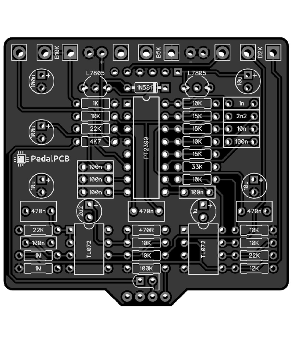

The Spirit Box is a Accutronics “Belton brick” powered reverb unit capable of light springy sounds to haunted castles full of cavernous screams. Very flexible control set allows you to dial in anything from country slapback tones to massive depth shoe gazer type reverbs.
- Attack – Controls the length of Pre-Delay
- Dwell – Adjust the length of decay (feedback is normal at extreme settings)
- Depth – Adjusts the wet/dry signal mix

Very very nice sounding spring reverb pedal, lots of great settings and sounds over moist of the range of dials (not like some reverb pedals that only have one sweet spot). Very worthwhile build, well designed pcb!
Russell C. (verified owner) –
Great layout and sound. Though, If you want it oscillate like the EQD Ghost Echo, it requires a tiny bit of value changes. Definitely going to stay on my board. PedalPCB is doing the dark lords work \m/

Great pedal. Easy build. Just make sure you can find the belton brick. They were sold out everywhere at the time of my build.

After upping R4 to 18K this ones a keeper. I always had love/hate relationships with reverb but i like this one.
Great board and great pedal. Borders on a reverb/delay pedal as you can get some slapback lsounds out of it. Make sure you can source a belton brick as it will be the most expensive part of the build and can be tough to find.

This thing is absolutely amazing. It sounds fairly articulate. It’s rather quiet, but this may be a result of the mod I did to achieve self oscillation (far from perfect but pretty cool, recommend you try it, the tips are on the forum). Absolute pleasure to build, too.

I just finished this build tonight. I plugged it in and thought that is a really good sounding verb! But as I messed around with it I realized that the middle knob wasn’t really doing anything. Did some research and found that R4 should be 18K not 10K. It is like that on the original and other clones. I changed out the resistor and the result is amazing! Would give 5 stars except that they need to change the documentation. If you build this with that one little change, you will be blown away by what it can do!
PedalPCB –
Changing R4 to 18K is a popular DIY modification but not the stock value used in the original.

This is my favorite pedal I’ve built since getting into the hobby! After reading reports from others, I built it with the R4 18k mod and absolutely loved it! My friend asked if I had a reverb I’d be willing to sell so I just sold them this one and am fully intending to build another now!

Great build! I am building my second. I also built mine with R4 – 18k.
