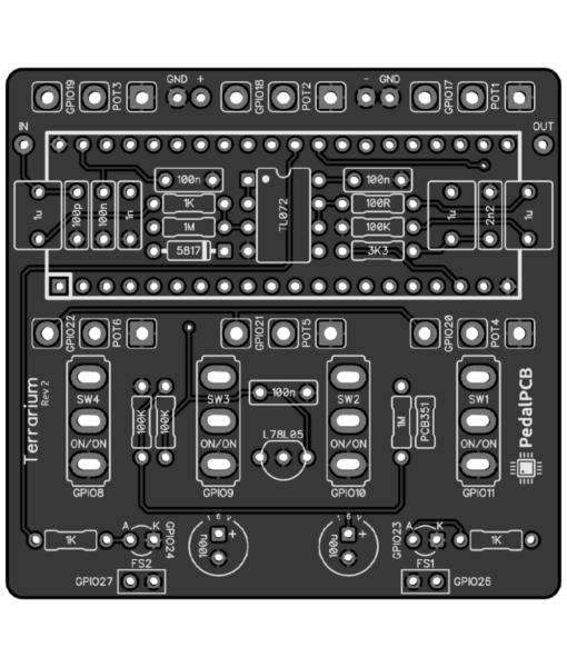

The PedalPCB Terrarium is a compact pedal interface for the Electrosmith Daisy Seed DSP.
- Six Potentiometers
- Four Toggle switches
- Two Momentary Footswitches
- Two LEDs
No components, hardware, or Daisy Seed is included.
