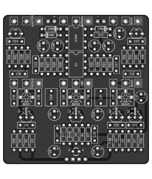

tcoffel (verified owner) –
Loving this build so far! Make certain your 2n5457’s (if that is what you are using) are genuine, or else your BIASING will have major issues. I had fakes, or TERRIBLY spec’d variants from Amazon, and couldn’t bias any lower than 11.1v. With GENUINE items, I was able to bias @ 4.5v.
On that Note, 2n5457’s sound good, but for what it’s worth I had some 2n5485’s laying around while waiting on genuine 5457’s, and I think I like their sound a bit better! It’s all about the experimentation to dial in what you like.
All in all, you will NOT regret this build, and you MUST BUY IT NOW!

I like it. Can confirm that putting other drives / fuzzes in front of the pedal can yield very good results. The EQ section is not my favorite, but it gets the job done. It is a nice tool for pedal stacking experiments. Bias your FETs at around 4.5V

Once you get your JFETs biased up this thing RIPS. It gets that full, rich, sludgy sound that you absolutely need. It actually gets a nice shimmery clean when you use just the brite channel set low!
