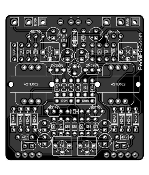

The Octanaut is an octave pedal designed to shift the pitch of single notes by one or two octaves.
- Octave 1 – Controls the volume of Octave 1
- Octave 2 – Controls the volume of Octave 2

bb_soup (verified owner) –
Underrated effect. Socket your diodes, you may want to match them or use lower/higher Vf. One of the LEDs is facing the opposite way I thought it was going to, so watch for that. It’s also not easy to calibrate without a scope, i tried it by ear first and I was way off.
