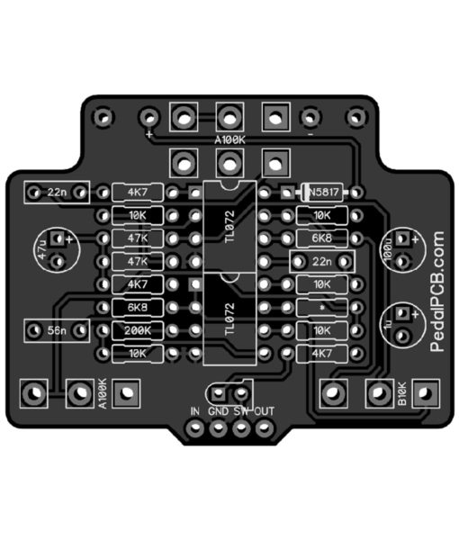

- Frequency – Adjusts the center frequency (70Hz – 1.4kHz)
- Boost/Cut – Controls the amount of boost/cut of the selected frequencies
- Gain – Controls the overall output signal level

Sounds great and it’s going to be a lot more useful than I first thought it would be.
Dial it in so the guitar cuts through, or scoop the mids for a fat jazz tone.
It does “thump” when it’s turned on, so I added a 1.2M resistor from BO to GND. Easy fix.

Nice, clean build, as expected, and it does what it says on the tin, all the way up to treble boost. Adds negligible noise if any. Just finished it, so I haven’t yet figured out how I am going to use it, but I’m pretty sure that I will–sounds great. BTW, although it is supposedly designed for a 125B size enclosure, I built it in a 1590B with no problem, just no battery and side mounted jacks.
bniderlaw (verified owner) –
Had to drop it down a star because of the popping. I added a resistor to ground at the input, and cobbled in the AMZ 2-resistors-and-a-cap LDR substitution, and still, it pops. Not sure what else to do. But it still sounds great, and has a million uses–if only it didn’t pop!

Holy f’n boost. Seriously. Volume to spare. Frequency is wired in reverse – high end CCW, bass CW – wish that the volume went below unity without cut, and for a higher treble frequency. Still 5 stars.
