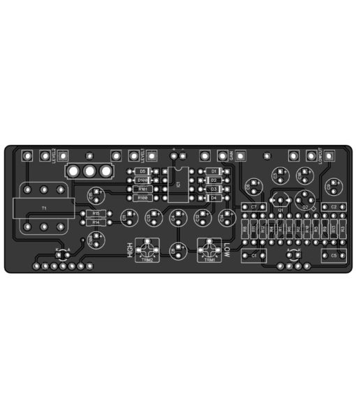

- Low Cut – Attenuates low frequencies
- Gain Trim – Controls the gain of the unit
- Level Low – Controls the overall output volume in Low Gain mode
- Level High – Controls the overall output volume in High Gain mode
- Gain Low (Internal Trimpot) – Sets the Gain in Low Gain mode
- Gain High (Internal Trimpot) – Sets the Gain in High Gain mode
- Voltage (Toggle Switch) – Selects between 9V / 27V operation
- Active/Bypass (Foot Switch) – Activates/Bypasses the pedal
- High/Low Gain (Foot Switch) – Selects between High Gain / Low Gain modes
- Designed for a 1590BBM enclosure with top-mounted jacks
