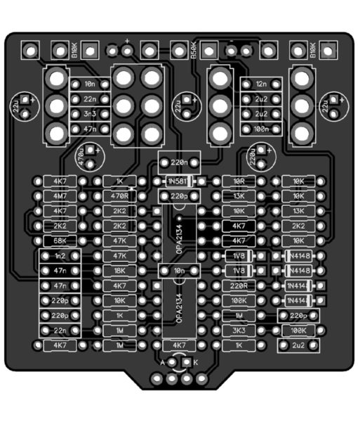

New Version
- Updated design uses 1/4W resistors
- True-Bypass switching
- Hi-Cut
- Cab (toggle switch) – 4×12″ / Flat / 2×12″
- Presence (toggle switch) – Hi / Flat / Lo”
- Voice (toggle switch) – Modern / Traditional”
- Brite(toggle switch) – Hi / Off / Lo”

brianthornock (verified owner) –
The layout is beautiful as usual, but I did have a problem with the bypass signal (pedal is not true bypass) being MUCH louder than with the effect engaged. I ended up wiring in a small trimmer as buffered bypass volume control.
Additionally, I don’t find it to be quite as “clean to scream” as some of the demos show. Still, I think it’s a great build and worthwhile.

szukalski (verified owner) –
Brilliant pedal. I recommend using log pots to have more control over the lower positions. Now you can dial in low-mid gain sounds better.
