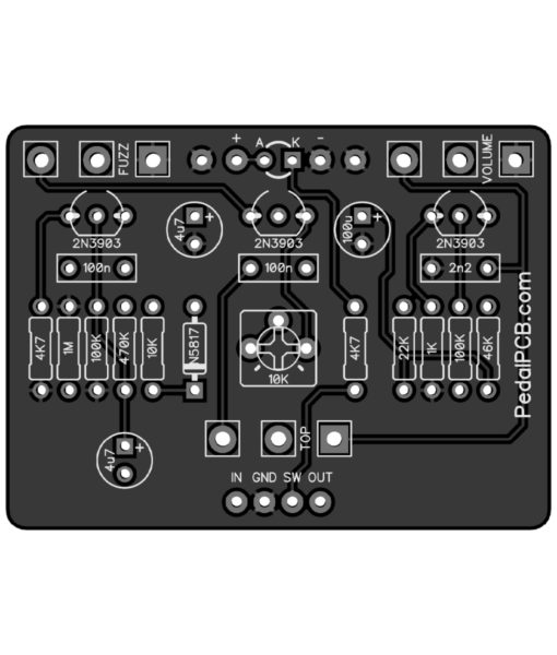

If I were to do it again, I wouldn’t get the Tayda 3-knob (Type 1) pre-drilled enclosure. The LED pads do not line up with the LED hole on the enclosure. Same issue on the drill template.
The trim pot is there to bias the 3rd transistor. Have to experiment to see how it effects the sound. I couldn’t find this information anywhere in the documentation or on the product page, so I had to look it up on the forum.
