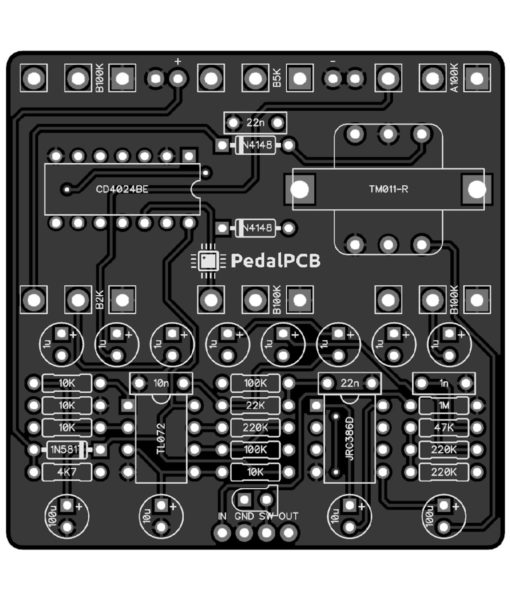

The Captain Bit is an all analog monophonic guitar synthesizer. It has a four octave range from two
below to one above and tracks surprisingly well for being analog. As with all analog octave machines it
does work best with the neck pickup and using a little boost, overdrive or fuzz in front of it. Keep it near
the front of your signal chain for even better results.
The Base, Sub, Down, and Up controls are independent blend controls.
- Level – Controls overall output volume
- Filter – Controls the overall tone of the circuit, noon is flat and gets darker counter clockwise and brighter when turned clockwise
- Base – Adjusts the level of the root square wave
- Sub – Adjusts the level of the -2 octave voice
- Down – Adjust the level of the -1 octave voice
- Up – Adjust the level of the +1 octave voice

This was my first PedalPCB build. Absolutely no problems building it, worked perfectly first try. The -2 and -1 octave track perfectly with the Strat neck pickup, and I get all the glitchy, growly robot mayhem. I put a phaser and delay after it. You know it’s working if your wife gets up and leaves the room. I’m building the Muroidea and MOSFET Driver next! Thanks PedalPCB!
giovanni (verified owner) –
This was a pretty easy build even with the six knobs and the transformer. Definitely a tight fit but the board is very well designed. The pedal sounds really cool, with lots of low-fi synth sounds on tap. Don’t expect a clean octaver, this is all square wave sounds!

BUT make sure to orient the transformer correctly as I didn’t the first time, and desoldering it was like doing surgery on a grape.
